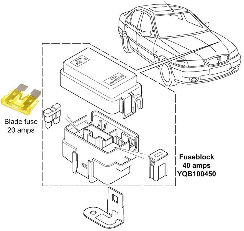

Honda engine 1600 Automatic gearbox ABS fusebox
